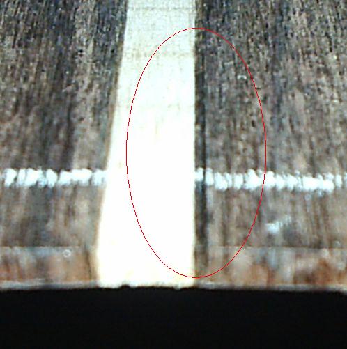

Hi Everyone,
I bought a classical serviced kit from LMII (Englemann Spruce with EIR Back)
Recently after bracing the back, I noticed a crack at the top part of the back where there is no back reinforcement
The struts for the back was planed to a curve.
Then the back was braced using free from (no radius dish)
method: only clamps and curved braces.
After the back was braced then I add in the back reinforcement strip.
Question is do I need to do anything to the crack?
It is located at the joint EIR - Maple strip - EIR part at the place where the Spanish heel is supposed to be
Or will it mend itself once the I glue the back to the rest of the assembly?
Thanks for the advice.

PostPosted: Tue Sep 25, 2007 2:02 am
Welcome,
I pretty much agree with Hesh's assessment, except about the brace removal.
It may not be that serious, especially if the crack pretty much is closed.
As he says, what caused it. IF flexing the back or rough handling caused it then I'd just super glue and clamp.
If you do this and it holds together once released from clamping, it should fly.
If it pops open, well, then follow Hesh's plan it's a good one.

Hi Hesh,
Thanks for the fast response.
Ashamed to say, I did not control the RH in my room as I have no means to control the RH...
I have measured the RH; it can fluctuate anything from 59% to 80%
I will monitor if the crack develop any further.
If it doesn't, could I just glue it up the crack?
If it does then I am clueless as to what to do to remedy it...
Sen.

Hi Bruce,
It might have been caused by the curvature of the brace.
I did not use any form of radius to guide me when I plane the brace's curvature.
So the curvature at the joint might be have too steep a gradient.
What I did noticed is that if I flatten that part of the back the crack does seem to close back.
If I need to remove the back brace. How do I do that?
I am using Elmer's Probond glue to glue the back brace

PostPosted: Tue Sep 25, 2007 2:23 am
If you take the brace off I just plane mine off with a hand plane and then use a scraper to clean them up.
You really need to get control of your humidity and get some form of a radius tool, at a minimium you can buy a lexan radius gage from Luthier Supplies (listed as a sponsor above) or get a radius dish. You will need this for various tasks...
Welcome to guitar building. :-) Don't sweat it. There will be lots of situations like this.

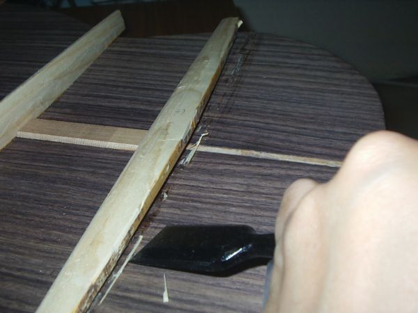

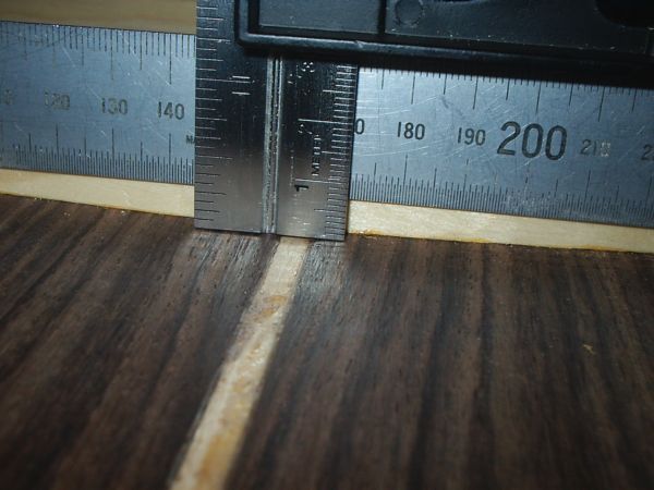

I have measured the curvature, it is indeed abit too exessive about 7-8 mm.
So I chiselled the braces away.
The bracing will be plane to a depression of about 4mm (about 20' radius)
When clamping I will use a air tight plastic bag with the silicon gels inside.
Thanks for your time and advice.

PostPosted: Wed Sep 26, 2007 8:15 am
Hi Goh, welcome to the OLF, I think your the first member from Singapore
Looks like you have some good advise already. I would like to talk about something else if you don't mind.
From you last picture there it looks like you just popped the brace off, is that correct? You shouldn't be able to pop the brace off with a chisel at all. There should be some wood failure otherwise your glue joint was was starved or something else. From your picture there are only slight bits of spruce on the rosewood and a few glue spots too. Now maybe you heated up the brace first, but I think you may have had a bad glue joint there.
Oh and I don't think your curvature is to much, just ask Dave White (UK) how tight his back curvature is, I think he uses 12' radius when most of us use 15'.
PostPosted: Wed Sep 26, 2007 8:41 am
I would agree with Rod here. If the brace popped of as it appeared in the photo then you would likely of had a brace failure in the future. I don't mean to be a barrier of bad news but if this is typical of any of the other braces then I would have concerns on all of them. The lack of failure in the spruce in the middle of the brace area when carving or as you did prying off would lend me to believe that you had bridging where the spruce is not in contact with the wood at all and the glue was fill a void. Or as Rod said the it was glue starved.
I certainly hope to be wrong here

Hi Rod, Michael
Thanks to all for your feedback and valuable advise.
This is such a wonderful forum; I learnt so much from you guys.
You are right, the brace came off pretty easily.
I applied the gluing evenly and thinly by hand on the brace.
I think the brace's gluing surface is not flat at some point.
Currently, I am using free hand and a Stanley block plane level the brace.
The only way to ensure the gluing profile is flat for me is by visual inspection.
Do I need a sort of jig in order to ensure the the brace's gluing surface is flat?

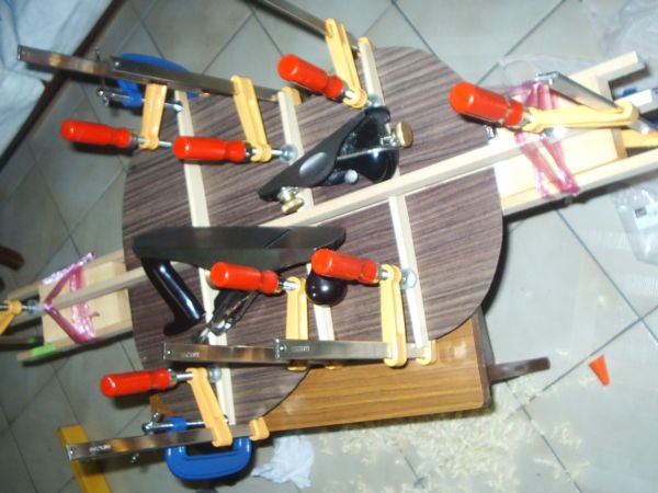

How are you clamping these braces?

Hi Brock
I attached a pic of how I clamp.
I will improve upon the process as I am thinking of using wedge much like the way we do a back joint or top joint.

I hate to be discouraging... but I would HIGHLY recommend building or buying a few tools. It will greatly help you on your quest.
First, make a couple radius dishes. You can make them pretty easily out of MDF or high quality plywood. If you search the archive you can find a technique for doing this, but essentially you make a couple of rails with an arc cut into them that the router can ride on as you carve out a dish.
And the second thing you should build is a go bar deck (there was a recent thread about this as well). It will help a TON with clamping braces and other parts of the guitar.
